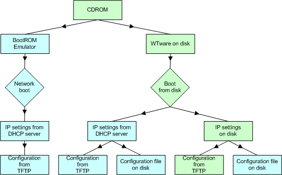

Boot from CD-ROM
Boot from CDROM
Create boot CD Image with the help of "WTware CD Image generator". It is available at Start > Programs > WTware > Boot from CD > CD Image generator.
The fastest way to boot WTware:
1 Specify IP parameters:
makeiso
In the field 1 specify terminal IP-address. Remember, that every computer (and every terminal, print-server, WiFi access point, ADSL-modem and any other device) should have unique IP-address in the network. In the field 2 specify address of the computer where WTware is installed and WTware TFTP service is started. Terminal configuration files will be stored on this computer.
2 Specify that configuration file should be downloaded from TFTP server:
makeiso
3 Press "Generate CD Image" and select where to save image file. Use any program to burn CD, all CD record programs work with .iso images. Attention, write file to a disk AS CD IMAGE, NOT AS DATA FILE.
4 Boot terminal from this disk. If everything is right, you'll see a screen with the text "Congratulations, you've loaded WTware terminal!". Next step is to tune the terminal or try another, more convenient boot way.

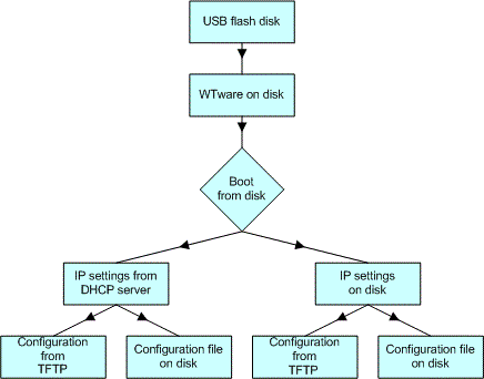

Boot from USB flash disk
Install WTware to a USB flash disk with the help of "WTware USB BOOT" program. It is available at Start > Programs > WTware > Boot from USB > Setup to USB-flash.
Boot form USB storage
You can select whether to write configuration and WTware license files to the disk.
When terminal starts from the flash-disk you can edit configuration file or specify that it should be downloaded from TFTP server. Also you can select whether to IP parameters should be received from DHCP by network or stored on the disk. Press Del during boot to access terminal configuration menu.

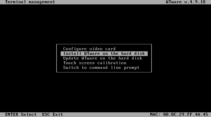

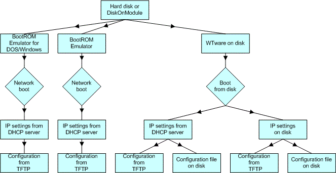

Boot from hard disk, IDE-flash, Disk-On-Module
Boot from IDE hdd
Hard disk can contain BootROM emulator. This emulator can be started either from DOS (or Windows 95/98/ME, user can select from menu during boot), or from hard disk without operating system. In this case terminal boot is similar to network boot from network card with BootROM. See documentation for more details about BootROM.

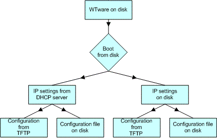

Also WTware can be installed on a hard disk. You can select - whether to download configuration file from TFTP server (that is more preferred for all configuration files are located on the single server) or to store it on the terminal disk. If it is stored to the disk you can edit it directly on the terminal. Also you can select whether network settings should be received from DHCP by network or stored on the terminal disk. The terminal that stores configuration file and IP settings on its hard disk requires no network services working. Such terminals are convenient for remote offices.
WTware installation requires at least 16Mb hard disk, i.e. IDE flash-disks will do perfectly. Remember: WTware installes itself on a hard disk, and there's no any other way to install it now. I.e. to setup (and upgrade versions further) you are to boot the terminal using any other way: from CDROM, USB-flash or by network. Press Del during terminal boot and select menu item "Setup WTware on hard disk". Hard disk should be connected as Master device to the first (or zero) IDE channel.
